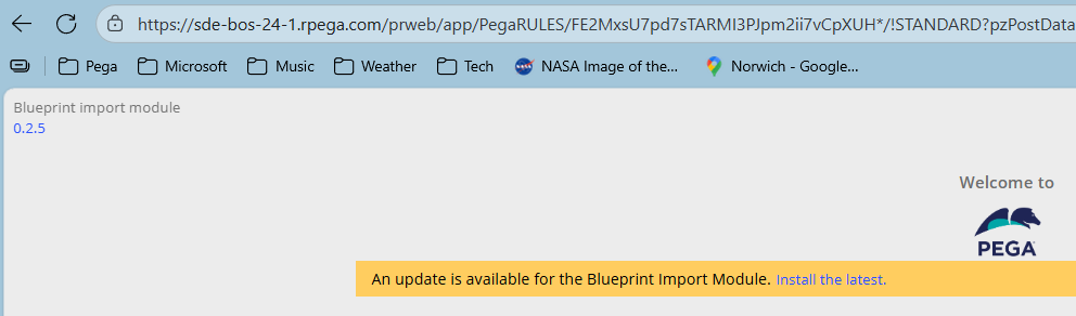

When I login to a system and see "An update is available for the Blueprint Import Module" I select "install the latest" right there. Most of our systems get upgraded to the latest blueprint version this way.
A couple of systems this fails. No errors, just a spinning wheel. Refresh and it still shows update is available.

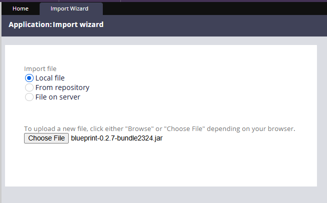

For those systems, when I download the latest blueprint module and try to import it via Dev Studio, I see the following error:
"Non-Branch RuleSets cannot be imported into this system. Contact your system administrator for more information. Archive: blueprint_rules.zip, RuleSetName: PEGA-COMP-BLUEPRINT"
