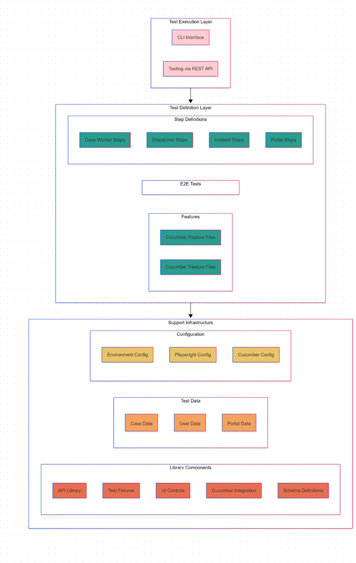

Having our tests up and running; it is now time to understand how it works so that we can tailor it to our needs. The goal for this code was to make it modularized and reusable so it can be easily used in other projects. Code is split into several logical modules and modules on top reusing logic from bottom layers.
- Code inside Library components layer serves as the foundation. It is the reusable code that is utilized by code in upper layers. Test Data layer is logic handling seed data so we can run tests with different sets of data.
- Configuration layer sets the scene for tools we use, Playwright and Cucumber. It consists also .env file that sets our environment variables.
- Test definition layer is where logic for our test is defined. This layer reuse logic from layers below implementing DRY rule (do not repeat yourself).
One potential extension to be implemented is to create some way to execute those tests. Currently tests can only be run by a developer who has the setup done on a local machine. Potential improvement is:
- Create CLI tool the simplifies test running
- Spinning up web server so it is possible to trigger test via REST call.
Both the solutions would enhance the ability to interact with tests by users as well it would give ability to include those tests on CI/CD pipelines.

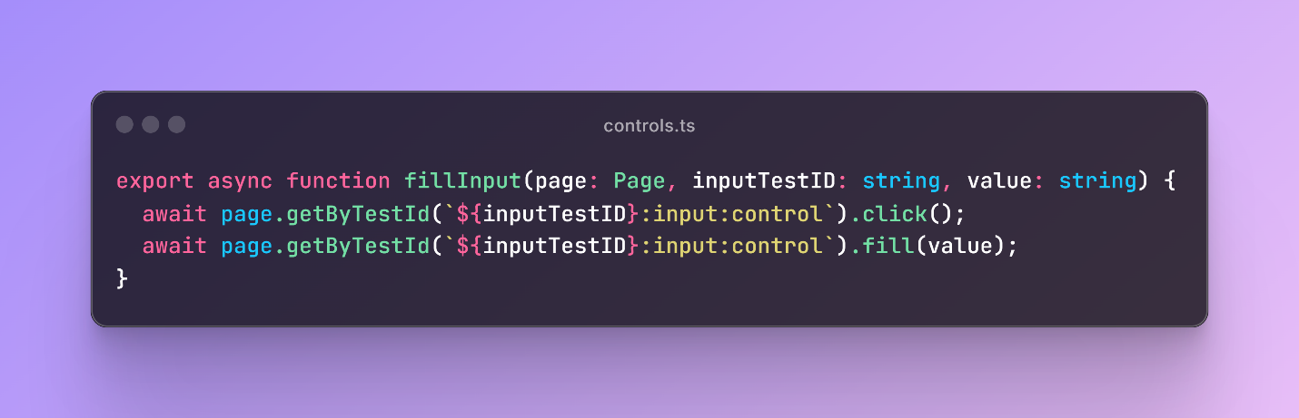

- low level API functions, so we do not repeat ourselves. Example: fill Input
Note: snippet above find element on screen using data-testid attribute that you need to set for each control in a View configuration.
Those functions are defined in https://github.com/kamiljaneczek/c11n-testing/blob/main/lib/playwright/controls.ts and are fully reusable in all Constellation based projects.

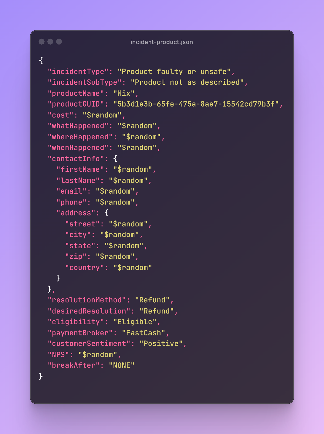

When running e2e we always start from the beginning of the process, data that we will use in testing the business process is defined in JSON file. Here is an example for testing Incident type
In our case we don’t require much data prepared upfront, files consist of data that simulates user input.

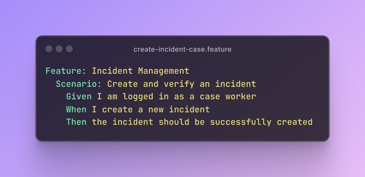

Defining a Feature File
Cucumber feature files describe test scenarios in plain English. Create a new file under features/:

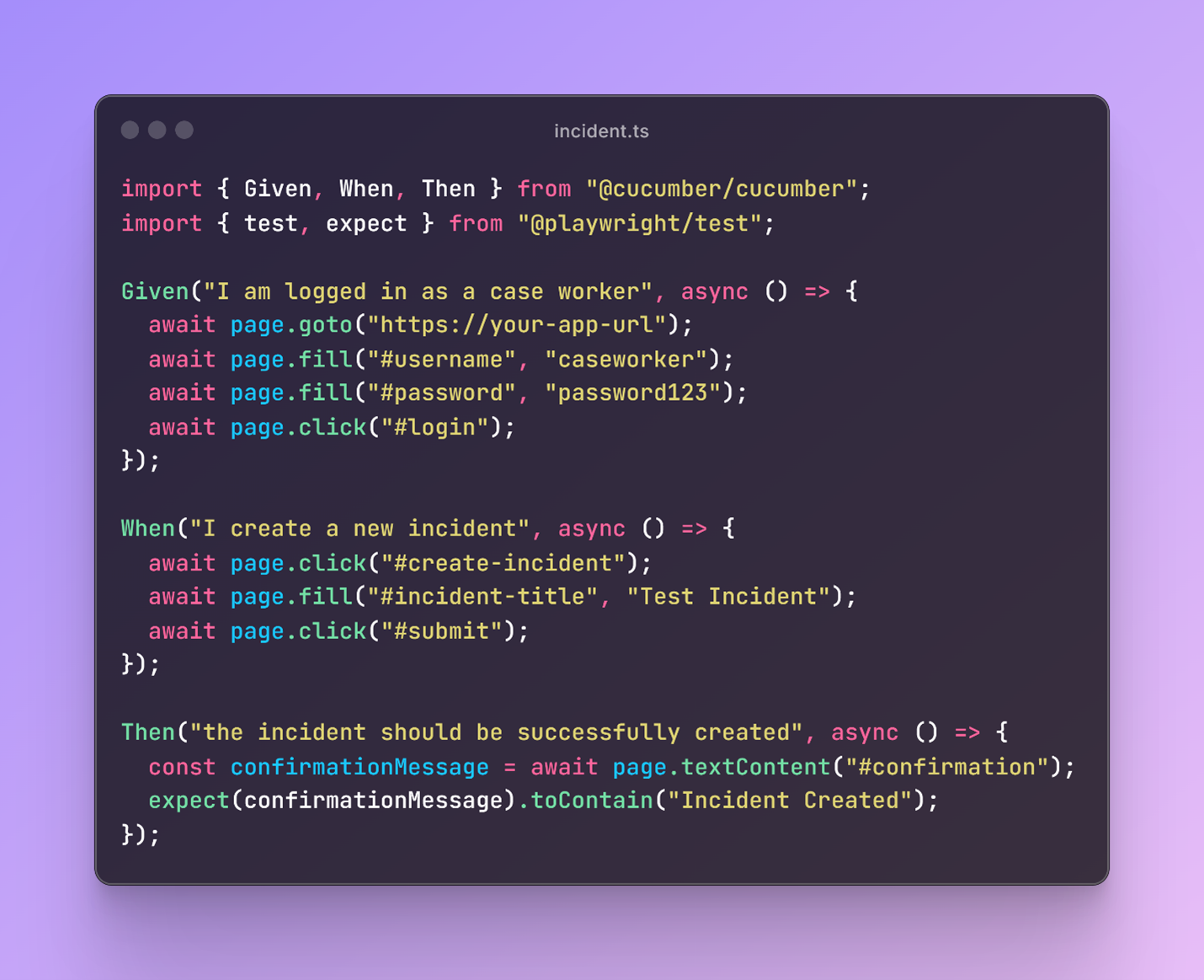

Map each step in /step-definitions/incident.ts file:
Understanding the Playwright Test Code
This test simulates a user logging into an application, creating an incident, and verifying that the incident was successfully created.

import { Given, When, Then } from '@cucumber/cucumber'; import { test, expect } from '@playwright/test';
Imports Explanation:
- The first line imports Cucumber's BDD syntax components (Given, When, Then) which provide a human-readable structure for your tests
- The second line imports Playwright's test and expect functions, which provide browser automation and assertion capabilities
Step 1: User Authentication
Given('I am logged in as a case worker', async () => { await page.goto('https://your-app-url'); await page.fill('#username', 'caseworker'); await page.fill('#password', 'password123'); await page.click('#login'); });
What's Happening:
- The Given step establishes the precondition - a logged-in case worker
- page.goto() navigates to the application URL
- page.fill() uses CSS selectors to locate the username and password fields and enters credentials
- page.click() submits the login form by clicking the login button
- The async/await pattern ensures each action completes before moving to the next one
Locator Details:
- The code uses CSS ID selectors (#username, #password, #login) to identify elements
- According to Playwright best practices, these could be improved by using more resilient locators like getByRole() or getByLabel() for better maintainability
Step 2: Creating an Incident
When('I create a new incident', async () => { await page.click('#create-incident'); await page.fill('#incident-title', 'Test Incident'); await page.click('#submit'); });
What's Happening:
- The When step describes the main action being tested - creating a new incident
- page.click('#create-incident') clicks on the button to initiate incident creation
- page.fill('#incident-title', 'Test Incident') enters a title for the incident
- page.click('#submit') submits the incident creation form
Automation Flow:
- Playwright automatically waits for elements to be available before interacting with them
- Each action is performed sequentially, mimicking a real user's behavior
Step 3: Verification
Then('the incident should be successfully created', async () => { const confirmationMessage = await page.textContent('#confirmation'); expect(confirmationMessage).toContain('Incident Created'); });
What's Happening:
- The Then step verifies the expected outcome - successful incident creation
- page.textContent('#confirmation') retrieves the text from the confirmation message element
- expect(confirmationMessage).toContain('Incident Created') asserts that the message contains the expected text
