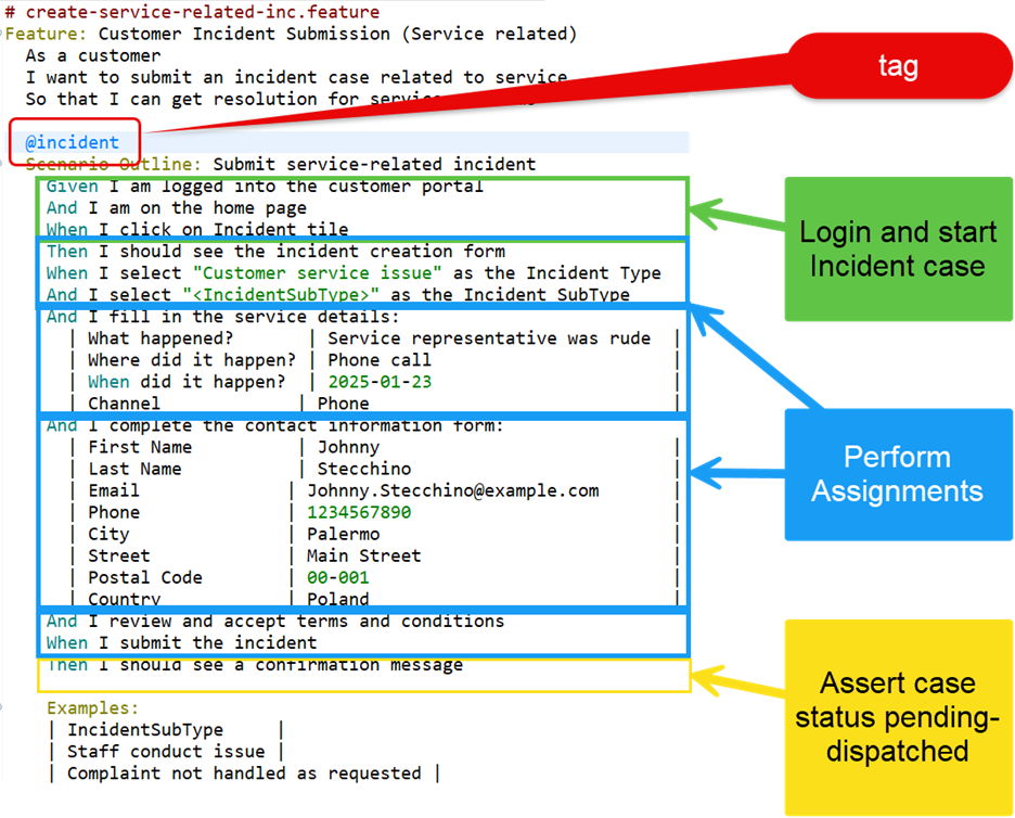

Below the image shows how the steps of an E2E can be expressed as elements in the cucumber features and how those elements are related to Pega application objects.
This feature will produce 3 test cases at runtime : one for each of the IncidentSubType ”Examples” at the bottom.
Notice that the assignments here are basically a collection of test data :
I select "Customer service issue" as the Incident Type - Use this to fulfil a single value
I select "<IncidentSubType>" as the Incident SubType - Use corner brackets to fulfill a single values by example
I select incident type "Product faulty or unsafe" with subtype "Product not as described" - Use this to fulfil two values
When the field number grows then is better use the table data approach as below
And I fill in the service details: | What happened? | Service representative was rude | | Where did it happen? | Phone call | | When did it happen? | 2025-01-23 | | Channel | Phone |

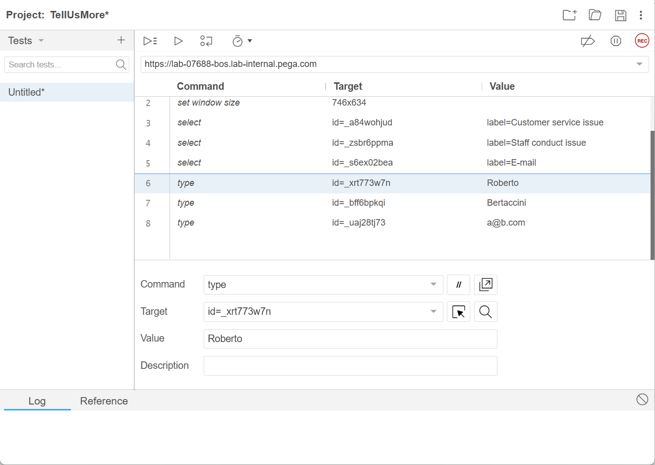

In any case Selenium offers a recording/edit/playback experience with Selenium IDE which is a plugin for any browser.

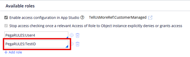

It is necessary to create test users dedicated for UI automation for each of the roles involved and add the role PegaRules:TestID to the access group.

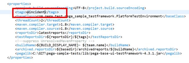

Copy your cucumber feature into /src/test/resources/features, set the same tag into pom.xml then run the project.

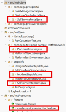

To implement the steps create a new class under src/test/java/stepdefs, for example IncidentStepDefs.java and paste the stub methods obtained in the last run.

This sample contains the implementation of POC on TellUsMore application :
PlatformBrowser.java : contains implementation for “Given I am logged into the customer portal”
SelfServicePortal.java : contains implementation for “When I click on Incident tile”
IncidentStepDefs.java : contains implementations of the other steps
create-service-related-inc.feature : is the feature file with scenario(s)
