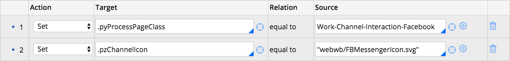

- Create Data-Channel-Configuration-<channel_name>.pyDefault data transform to predefine processing page class. Set pzChannelIcon to customize the channels application view icon. The image must be in SVG format.
