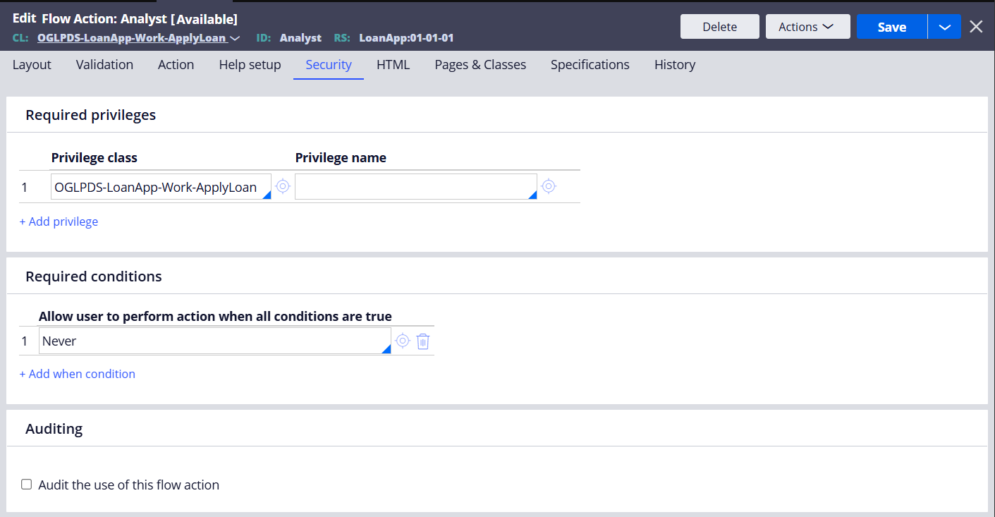

@Saroj.Panda could no found a option to hide we have fixed this issue by adding a Access when privilege on flow action, by this update you can still see the go button , but does not allow user to open assignment.
The go button will appear if you have admin privileges though the assignment is assigned to another user or work queue.

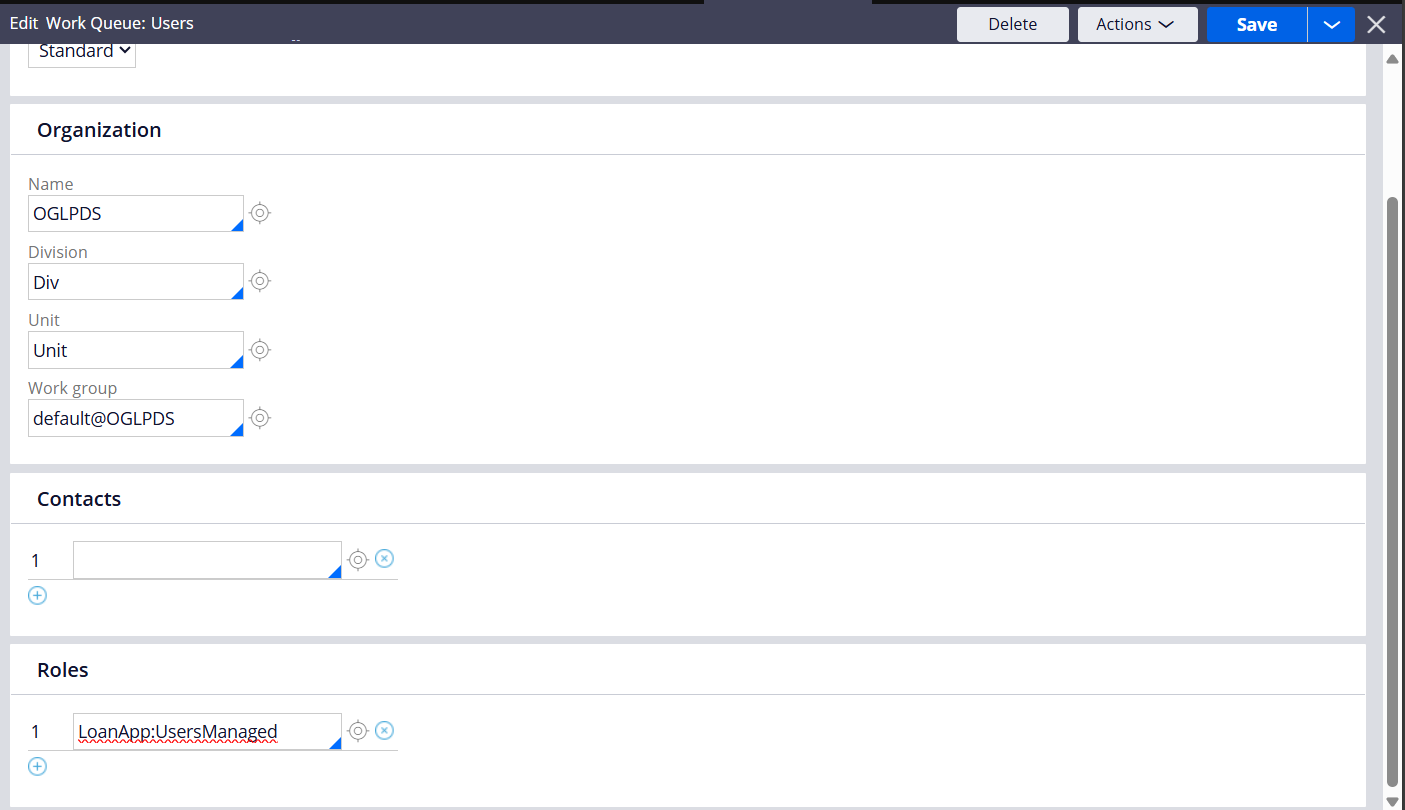

In Pega constellation, we are trying to restrict access to certain assignments which is routed to particular user.
When the assignment is routed to a Work Queue, the "Go" button is correctly restricted based on Access Roles. I have configured the necessary roles, and the restriction works as expected.

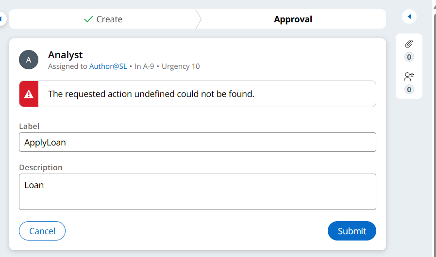

However, when the assignment is routed to a specific user (Worklist), I have tried to apply the same restrictions using Privileges and When conditions in the Flow Action Security tab, but the "Go" button is still visible and accessible to the user. And when they click "Go" it is automatically launching the pyEdit
Flow Action.
If I submits the pyEdit flow action, It throws the error which I mentioned below.
Flow Action.
