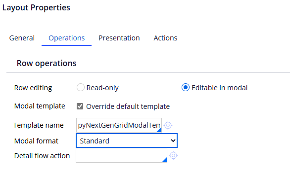

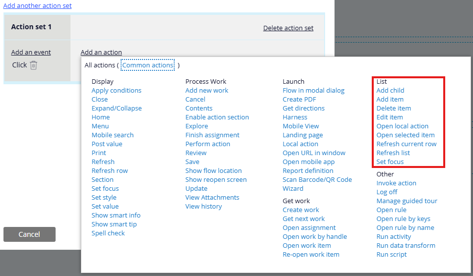

Dirty Dialog limitations in modal flow on Grids
The dirty popup will not work in scenarios where users want to use a flow in a modal dialog on the data of an optimized table (grid layout).
The flow in modal dialog action is not intended to operate within list (grid) or repeating dynamic layout scenarios. Editing a row will cause a global refresh making the dirty flag dysfunctional. The product is designed to reset the dirty check and discard the changed value.
Workaround
To perform any actions on the optimized grid, use one of the List actions which are specifically for performing actions on the grid, or use the Editable in modal option in the grid operations and add the flow action on the specified field.
