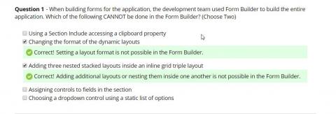

Can someone help me in understanding the answer for the below question ?

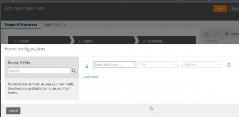

I feel, the option A is also the right answer since, we can't include a section from the form builder .
A "Section Include" (noun) is an embedded section within a section.
From 7.1.8 Developer Help https://community.pega.com/sites/default/files/help_v718/procomhelpmain.htm:
Section — Include one or more sections within another section. A wireframe appears around the included section, which is labeled Section Include. From the section's header, you can open the rule, and if enabled, use check in/check out features.
I hope this helps.
