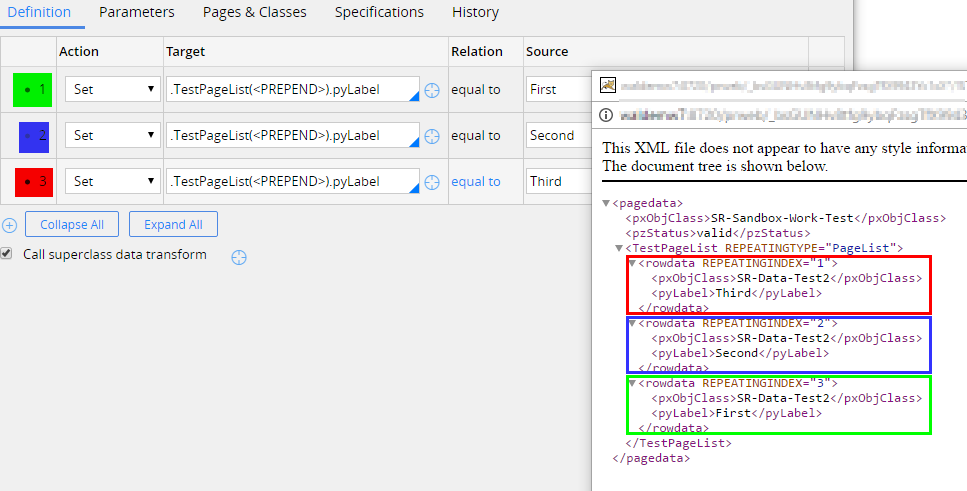

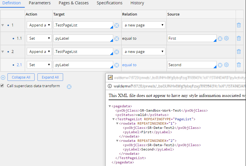

Is there PREPEND and MAP TO kind of action as opposed to APPEND and MAP TO in data transform?
I am appending a new page into a pagelist, using action append and map to, this appends each new page at the end of the pagelist on click of a button where I have called the data trasform. I have used key word LAST for each SET action in data transform. However, I need to PREPEND meaning, I need to insert each page as the first page of page list and older pages need to be pushed down each time I insert new page at index =1. This is to make sure the latest pages appear first.
Is there any work around or design consideration?
