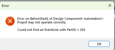

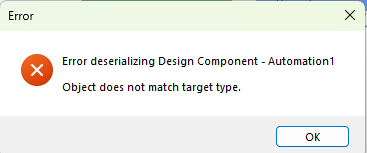

I decided to bypass the script in Pega and call the API directly from the automation. I've created the proxy of the class in the DLL, however, I am getting several errors when I add the events.
Exception from the log file:
Error | 11:07:42.807 AM | 7 | MTA | Exception | | | Could not find an EventLink with PartID = 204, Verbose Message: General Information

1) Exception Information ********************************************* Exception Type: System.Collections.Generic.KeyNotFoundException Message: "Could not find an EventLink with PartID = 204" Data: IDictionary (System.Collections.ListDictionaryInternal) with 0 items TargetSite: OpenSpan.Automation.EventLink GetEventLink(Int32) HelpLink: NULL Source: "OpenSpan.Automation" HResult: -2146232969
StackTrace Information ********************************************* at OpenSpan.Automation.Automator.GetEventLink(Int32 partID) at OpenSpan.Automation.CatchHost.mAutomator_LinksConnected(Object sender, EventArgs e) at System.EventHandler.Invoke(Object sender, EventArgs e) at OpenSpan.Automation.Automator.ConnectLinks() at OpenSpan.Automation.Automator.BeforeStart() at OpenSpan.Runtime.RuntimeContainerLoader.ExecuteBeforeStart(IDesignComponent dc, Boolean beforeStart) at OpenSpan.Runtime.RuntimeContainerLoader.Start(ISynchronizeInvoke syncObject) Verbose | 11:07:42.811 AM | 1 | STA | Runtime Application | | | WndProc message = 0000C255 Error | 11:07:43.438 AM | 7 | MTA | Exception | | | Could not find an EventLink with PartID = 204, Verbose Message: General Information

@ScottC37 Without access to the DLL, I can't really speculate. I suspect the first error is really a result of the second one. The missing link error would happen if any object had changed since it was opened in the automation surface. It may just be a case of a missing reference or something like that. You might open a support request to see if they can assist as this might need some hands-on to resolve.
