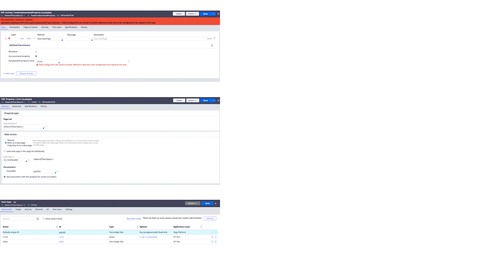

Savable Data Page - Use Associated Property - New Activity Save Error Starting from Pega 23.1
I have an activity built in Pega 8.5 that uses the Save-DataPage method with Associated Property, and it continued to work in Pega 8.8. Starting from Pega 23.1, the Activity no longer saves, and it's giving a compile time error.
"Field configured to be saved is invalid. Reference data has to be configured to be copied to the case."
The set up that I have is that I have a Data Type (L2) that references a "Query" list of another Data Type (L1) via a List Type Savable Datapage. The syntax was not failing in Pega 8.8, but it started to fail in Pega 23.1 and above. I this case, the property is of "Query" type and not of Reference.
Has anybody experienced this? Or is this the new behaviour?
