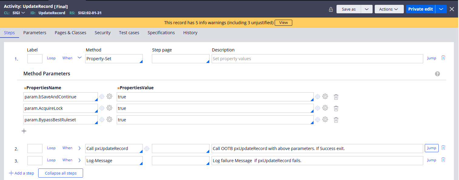

1) For opening a case we plan to use pxGetCase api - this internally does Obj-Open-By-Handle without acquiring lock.
2) For updating the case we planned to use pxUpdateRecord api. The good thing with pxUpdateRecord was that it was taking care of locking, staleness check and doing commit all within with good error handling. But looks like this pxUpdateRecord api doesnt support saving case instances as it was doing a Show-Harness on review harness. Looks like 'bSaveAndContinue' parameter is not passed correctly from Work-!.Save. This was confirmed by support team that pxUpdateRecord doesnt support case instances.
3) Other option was to use acquireWorkObject api to acquire lock, do the transformation and invoke Work-!Save API which even commits. [OR] call UpdateWorkObject with commitWithErrorHandling.
