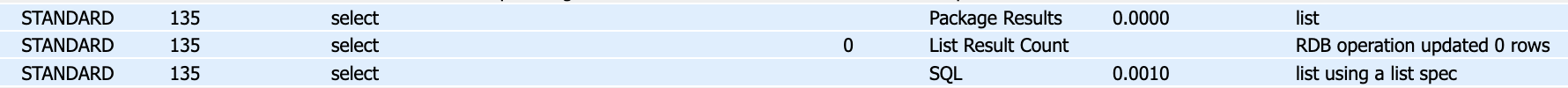

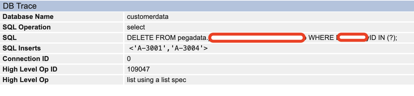

Hi, I have a similar issue where the delete failed to retrieve the results.
I wrote:
DELETE FROM {CLASS: {.pySearchText}} WHERE ID IN ({.pyTempText});
and trying to pass .pyTempText = "'A-3001','A-3004'"
my database has these records and the step looks correct to me, but no result returned. Any suggestions? Thanks!

I think Ramesh meant to capitalize some of the word: SELECT FROM ... WHERE ... IN
UPDATE: Hey, I think I figured it out. I added ASIS: and it resolved my issue
try SELECT * FROM tablename WHERE status IN ({ASIS:.Status})
Hope this helps!
