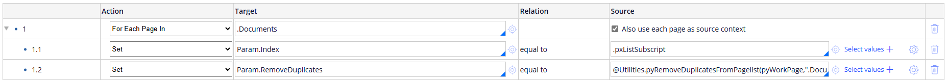

I have tested the solution above, which involves using a temporary page list to perform duplicate removal, and it works for me.
@Utilities.pyRemoveDuplicatesFromPagelist(RemoveDuplicates, "pxResults", "ppyEmail")
Could you try trimming the pyEmail
property (using @String.trim
) while creating the temporary page list? This will ensure there are no extra spaces that could cause the duplicate search to fail.
By the way, this approach only worked for me when using a temporary page list—see the attachments below.

The issue that I see in this kind of testing is that we are only explicitly removing the duplicates in the signatories of Documents(1) that is why it is working, and it will indeed work.
What we need to do is also loop through all of the indexes of Documents, so all the duplicates of all the signatories per Documents index are also removed.
That was why I added (Param.Index) in @Utilities.pyRemoveDuplicatesFromPagelist(pyWorkPage,".Documents(Param.Index).Signatories",".pyEmail") in my question above
Capgemini
FR
Have you declared index as integer?
If yes, I think the pyRemoveDuplicatesFromPagelist function does not recognize the parameter passed
I would recommend to leverage on the index to in a For each page in loop which set RemoveDuplicates.pxResults to Documents(<current>).Signatories
You would append back Documents(<current>).Signatories from RemoveDuplicates.pxResults for each page
Could you try this?
