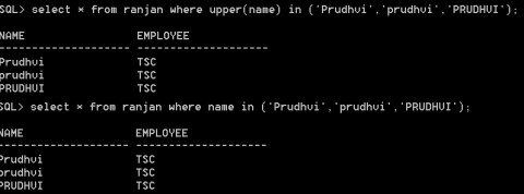

Hi Dilipan,
I have performed your scenario in my local oracle DB and it is appearing as below.
I don't find any difference in both the queries at my end. Can you please try your scenario without upper function.
Please let us know the parameters used in IN function of your query or provide sample records of your table.

Atos Syntel
we can form the queries in the Database directly, but can you form it using (the first query in your screenshot) obj-browse method in pega ?
