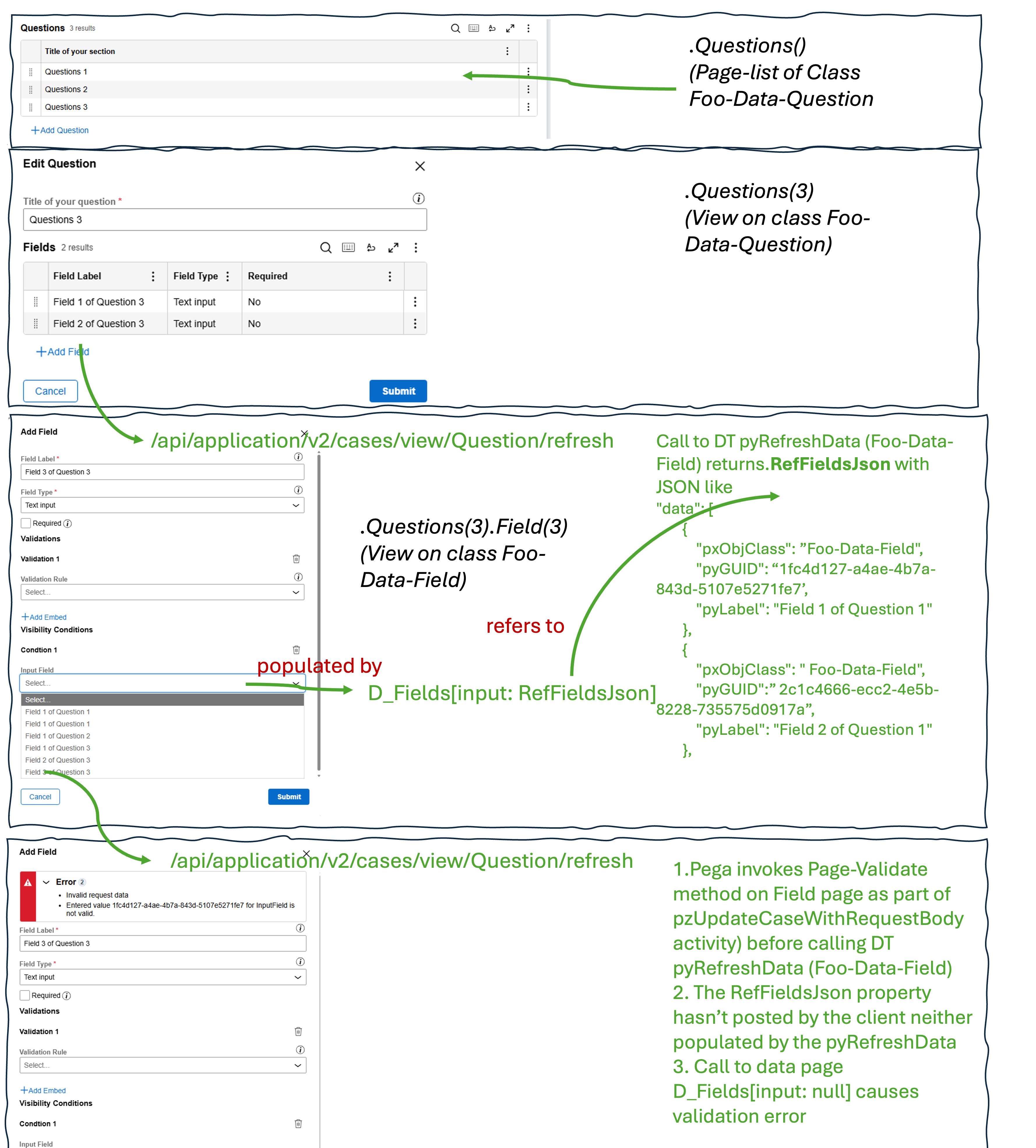

I’m working on a Constellation UI scenario where a dropdown needs to display values from sibling elements inside .Questions().Fields(). The user should be able to add new questions and fields and immediately select them - without submitting the assignment.
Here’s the challenge:
- Starting with Pega 24.1, data pages invoked from Constellation UI run in an atomic requestor context and do not have access to the case clipboard. This means the data page cannot directly reference case properties unless we pass them explicitly.
- The dropdown source is a data page, but since there’s no case context, I serialize
.Questions().Fields()into JSON usingpyRefreshDataand pass it as a parameter (RefFieldsJson). The data page deserializes this JSON and builds the dropdown options. - This fails during interactive refresh call. Why? Because
RefFieldsJsonis hidden and computed, not user-edited, so it’s excluded from the client-server payload. Pega ConstellationJS client only sends properties that are:- Defined in the view model
- Editable (not read-only/hidden)
- Updated by the user
As a result, the data page loses context during submit, and the save operation breaks.
What I’ve considered
- Forcing hidden properties into the payload (developing custom DX component) - rejected (risk of data inconsistency and unpredictable merges).
- Saving data on every refresh - rejected (violates volatile data principle and risks overwriting in-flight edits).
