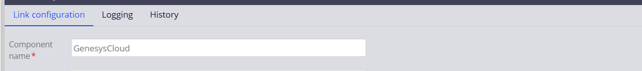

Hi @RameshSangili thanks for your support. I review the urls we are using a Genesys cloud link type EmbeddedUI. On this type of integration is not available the switch capabilities tab. Do you think this click to call has to be configured by Genesys cloud side?

Hi @RameshSangili thanks for your support. We are using a Genesys Cloud integration with link type EmbeddedUI. On this one doesn't appear the Switch capabilites tab. Do you think click to call has to be enable from Genesys cloud ?

Hi @RameshSangili thanks for your comments. I already review the urls. But we are using Genesys Cloud integration and Link type EmbeddedUI, for this switch capabilities not appears.
Do you think the click to call requires changes on Genesys Cloud.
