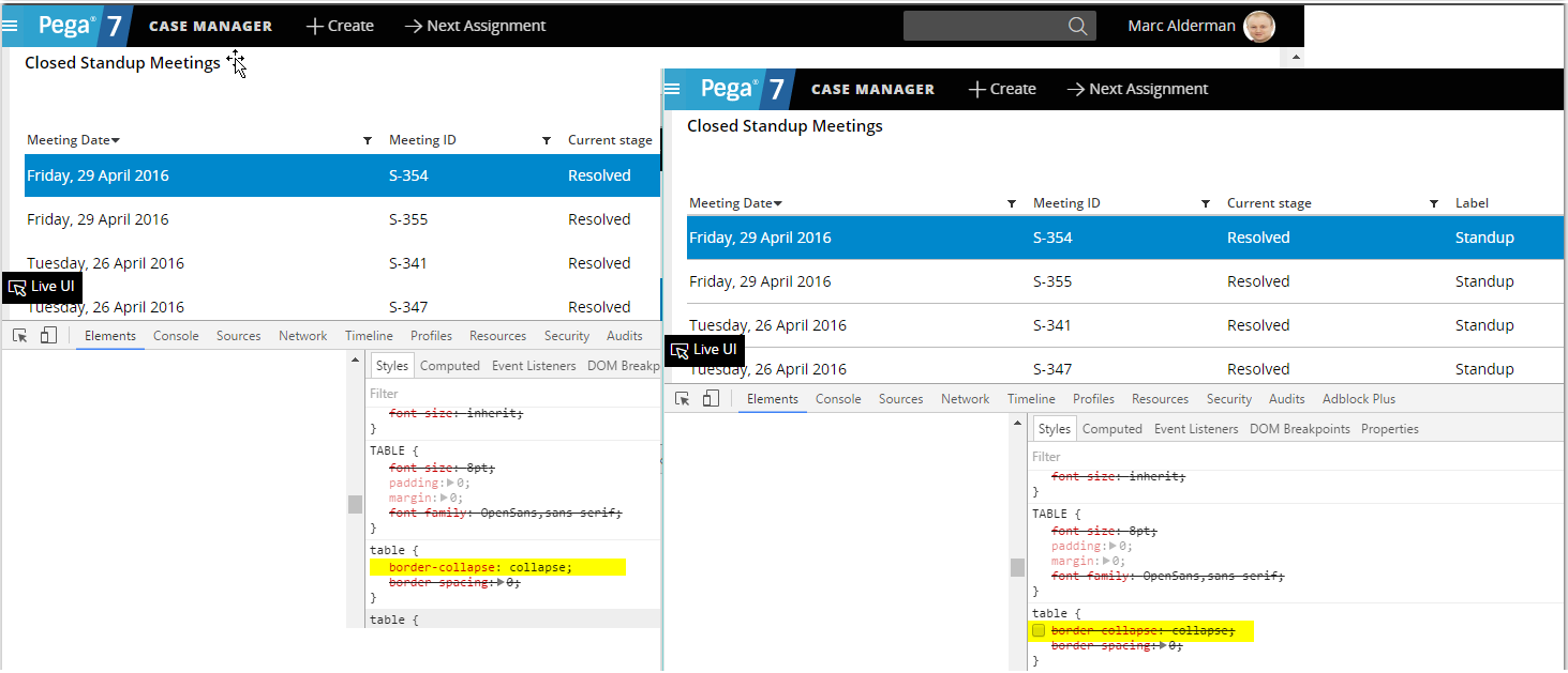

Chrome: Repeat grid displyaing differently

Hi Avinash,
I can also see the same behavior in the 2 browsers while using UI-Kit-7 in Pega 7.2
So, it should not be an issue with toolkit.

oh.. I thought it has something to do with the UI-Kit.
Any idea on why the screens are different in chrome and mozilla?

While browsing through web, I found :
https://groups.google.com/a/chromium.org/forum/#!topic/chromium-discuss/myYxO4EMj84
Probably because they define the border width as .5pt (0.5pt).
Half a point in CSS equals to 0.67 pixels (approximately).
Since a screen cannot show less than a pixel, less than a pixel equals no pixel - 0px, which essentially equals to no border.
Find and replace ":.5pt" with ":1px" in HTML and in CSS. That should fix it.
