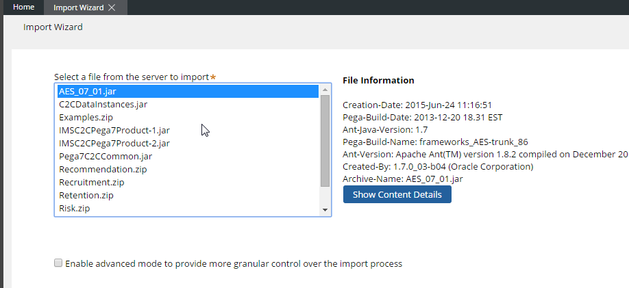

My client is currently implementing AES with AES 07.01.jar and has a few issues
1. The Enterprise Health is not showing any nodes (there should be 3 nodes listed in the Dropdown)?

5. Would upgrade to the AES 07.13 (AES_07_13_01.jar) resolve most of the issues above, if so can I simply import the new jar on top?
