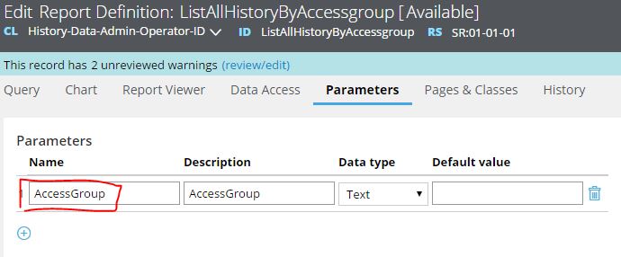

However, I couldn't make it happen on my local PE. Am I missing something here?

Below is the SQL which is found in the clipboard page, "pyReportContentPage".
SELECT "PC0".pxhistoryforreference AS "pxHistoryForReference" ,
"PC0".pxtimecreated AS "pxTimeCreated" ,
"PC0".pyperformer AS "pyPerformer" ,
"PC0".pymemo AS "pyMemo" ,
"OP".SRCOL3 AS "pyAccessGroupAdditional"
FROM personaledition.pr_history_data "PC0"
INNER JOIN
(SELECT "OP".pyuseridentifier AS "srcol1" ,
"OP".pyusername AS "srcol2" ,
"AG".pyaccessgroupadditional AS "srcol3" ,
"OP".pzinskey AS "pzinskey"
FROM personaledition.pr_operators "OP"
INNER JOIN personaledition.pr_index_operators "AG"
ON ( ( "OP".pzinskey = "AG".pxinsindexedkey )
AND "AG".pxobjclass = ?
AND "OP".pxobjclass = ? )
WHERE "AG".pxindexpurpose = ?
-- AND AG.pyaccessgroupadditional = ? <-- If the parameter had been passed to the sub report, then sub query should have included this filtering condition which is missing.
) "OP" ON ( ( "OP".SRCOL1 = "PC0".pyperformer )
AND "PC0".pxobjclass = ? )
WHERE ( "OP".SRCOL3 = ? )
ORDER BY 1 ASC,
2 DESC
pyPreparedValues(1) AdditionalAccessGroup
pyPreparedValues(2) Index-Operator
pyPreparedValues(3) Data-Admin-Operator-ID
pyPreparedValues(4) SR:Administrators
