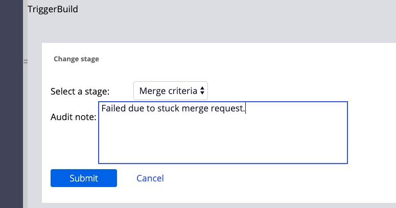

A single merge request is stuck in progress is blocking other merges
You can manually resolve this work object associated with the branch merge for that pipeline. The fix is basically to find the Pipeline-CI workobject associated with the application pipeline in question, and manually resolve reject it. For example, lets say there is a stuck merge request for
For the pipeline involved, let’s say in my case here, UPlusCSDev
In Designer Studio (for the Deployment Manager application), you need to find for this example, “Pega-Pipeline-CI-UPlus_CSUPlusCSDev” and open up the instance list
From there open up the work object and manually resolve them. To do that change the stage to “Merge failed"
If resolving doesn’t work, perhaps try deleting that case instance
