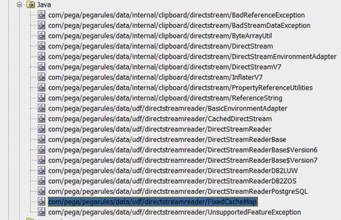

We are receiving the Java Classes invalid when importing the Rules Schema to the new Cloned one.
