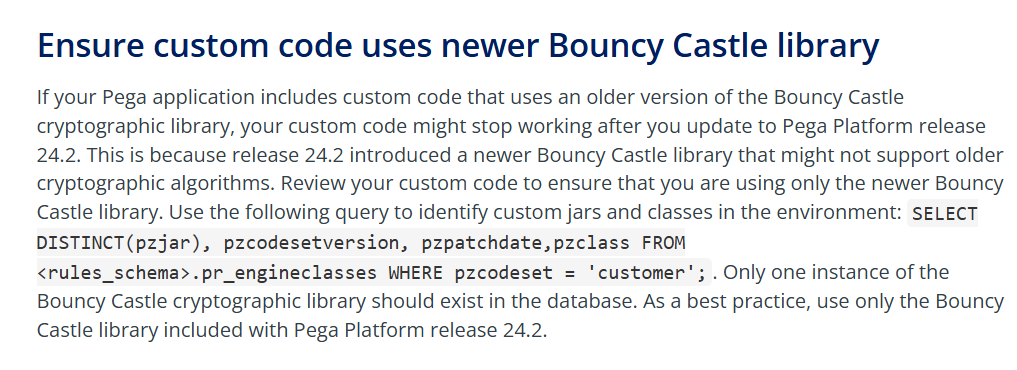

Can you try Arun Sarkar's solution as he was also trying to configure in 24 version. i guess he was also facing similar issue. try to Installed bcprov-jdk18on-1.80.jar in Tomcat and check.

@GuhanathanV4521 Hi Guhan, Which version of Pega have you implemented? I tried in 24.2.2 and the product documentation says it does not support additional version of bouncycastle jar cannot be imported. Also was it on pegacloud, if so how did you mention the public/private key path?
I tried to rebuild the same using the latest version of jar and converted the filepath to use file content.
