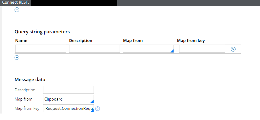

As per Client requirement we had to do use a different Grant Type "Resource Owner Password Credentials Grant / password" for integrating to an external system using Connect - REST . We are able to achieve this successfully with the below work around solution. Hope this approach helps you in solving any of your requirements.
Step 1: Test the Connection using Third Party tool such as Postman.
Step 2: Use Generate Code in Postman to see underlying code generated
Step 3: Frame the String in above Generated code in PEGA and pass to Connect REST (without any authentication) either in Body or Header as required by Client Application.
