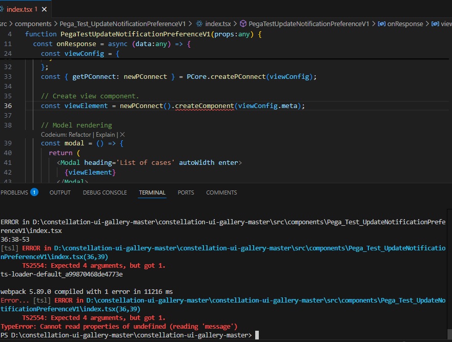

@baipc Thanks for posting on this topic. As per your suggestion, I'm trying to create a component and using the above mentioned code. But I'm getting error on calling API createComponent that all the required data source and additional properties are not passed. As you mentioned in the previous comment, I tried passing as empty object but still error persists. PFB the screenshot of the same. It will be really helpful if you could share the right snytax or arugments for the createComponent to be called in the context.
@Connect@Abicom This is typescript error, please ignore. @ghosa4 How to disable it?
BlueRose Technologies
@baipc @ghosa4 Thanks for the prompt response. What do you meant by ignore. Despite this compile time error, I tried publishing the component now but it fails while generating the build. PFB the screenshot of the same. I'm unable to test this component within Pega portal due to this issue.
Assistance on this solving this issue will be really helpful and greatly appreciated.
@Connect@Abicom Kindly try using the following syntax:
const viewElement = newPConnect().createComponent(viewConfig.meta, "", 0, {});
We will also address this in the upcoming release to make these arguments optional.
