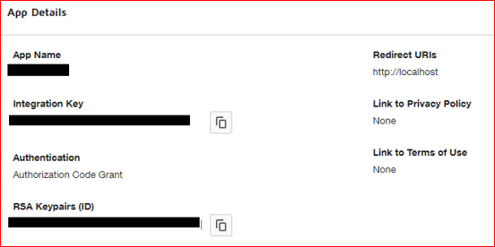

- Note down the Integration Key and setup authentication to ‘Authorization code grant’ and redirect URI to http://localhost if not defined for your application. Generate RSA file & pfx file as per pega documentation.

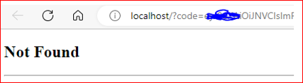

- Copy paste this link in browser https://account-d.docusign.com/oauth/auth?response_type=code&scope=signature%20impersonation&client_id=<<Integration Key>>&redirect_uri=http://localhost .
- Application is using JWT token to authenticate the service request hence you need to provide consent for the first time, use ‘service account configured for this integration, loginto DocuSign and provide consent. You would see an option to provide consent and then login. A blank screen will appear.

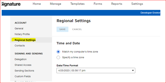

- Update regional setting and update the date format and time zone.

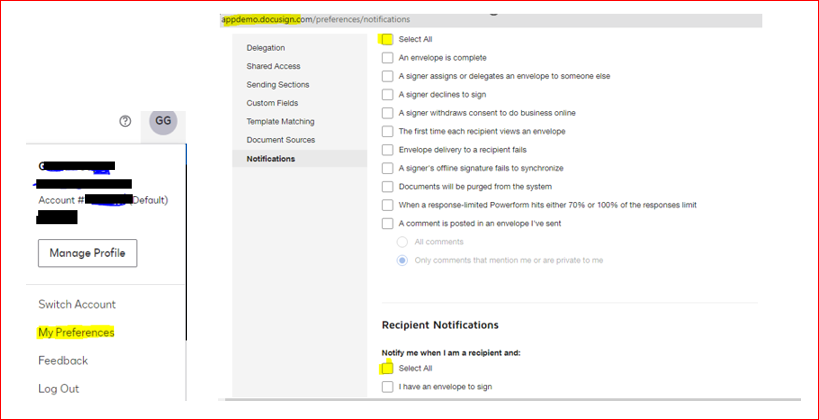

- If you don’t want to receive any DocuSign notification, then stop receiving such notifications by clicking on Profile-->Preferences--> Notifications and uncheck notification

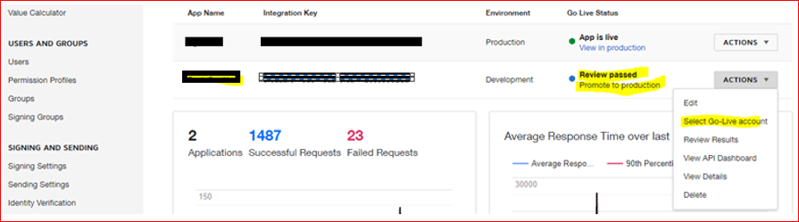

- Don’t wait for SIT/UAT Completion, promote your DocuSign Dev application for Production review. When integration with Pega is successful, Initiate at least 20 successful services calls and submit a request for production review from ‘Action’ menu.( production review option is not available as app is already in prod)

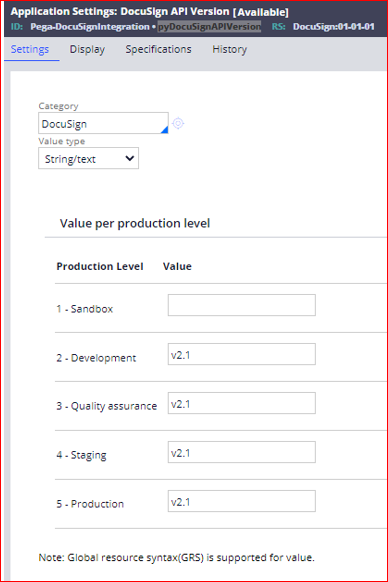

- Application setting was missed for API version. Created new Application setting for ‘pyDocuSignAPIversion’
