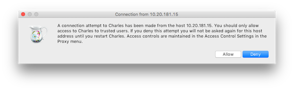

After that, you should notice a pop-up on your computer. You should click "Allow" to proceed.
