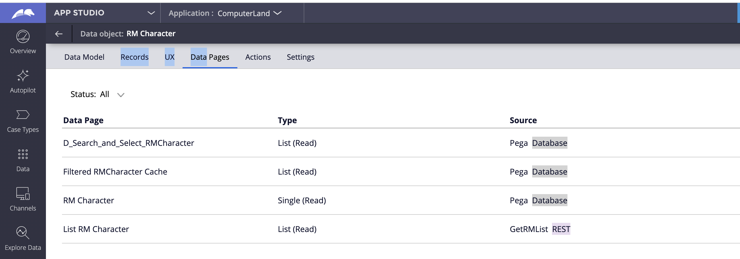

There will be three key data pages: one for the individual data object, one for the parameterized list of data objects, and one for the filtered results returned by the Search and Select interaction. A cache data page will be created in the next step.
2. Create a new List Data Page under the same object type to cache the search results.

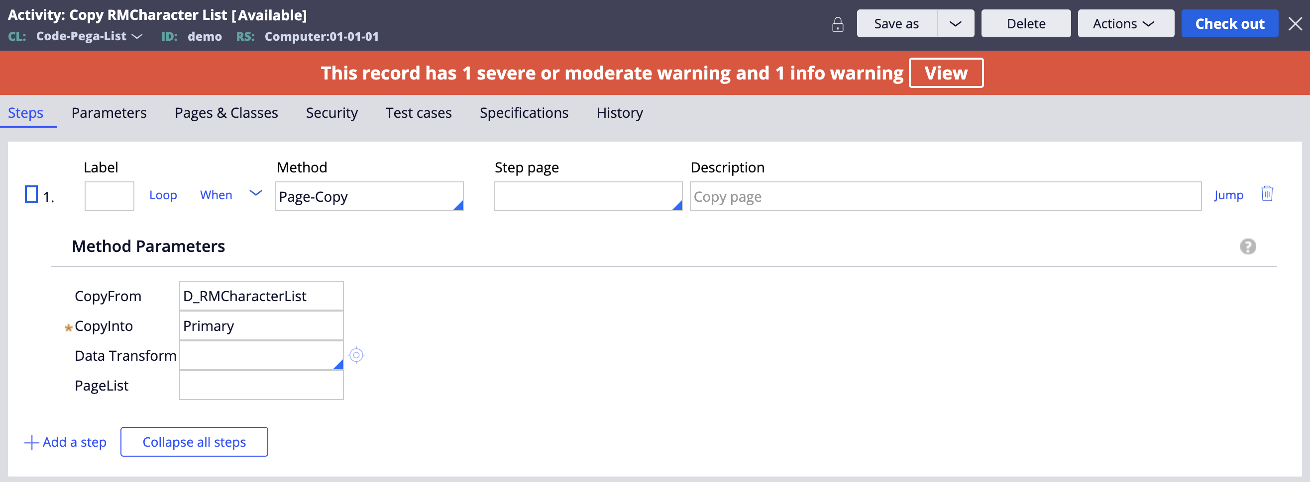

a. Select Activity as the Source and create a new activity that copies the parameterized list of data objects. tor

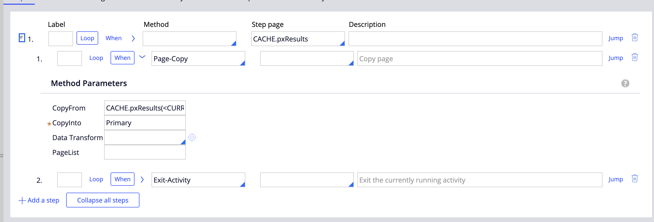

3. Configure individual data object Page to source an activity. This will build our selected list without making another request call to the external source.
a. The data page should accept a parameter that serves as the key.
b. The activity should iterate through the cache data page and copy the page that matches the parameter key.

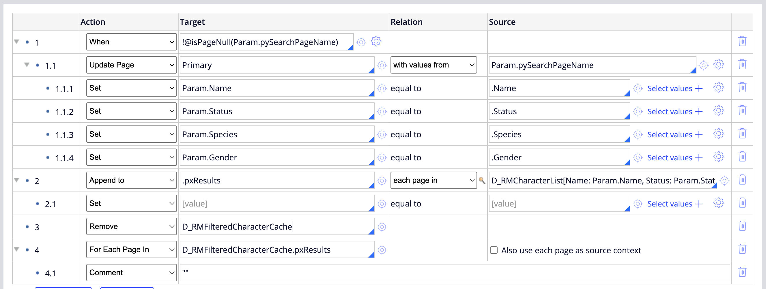

4. Update Search and Select Data Transform to perform the actions "Remove" and "For Each" on your cache data page as shown below.

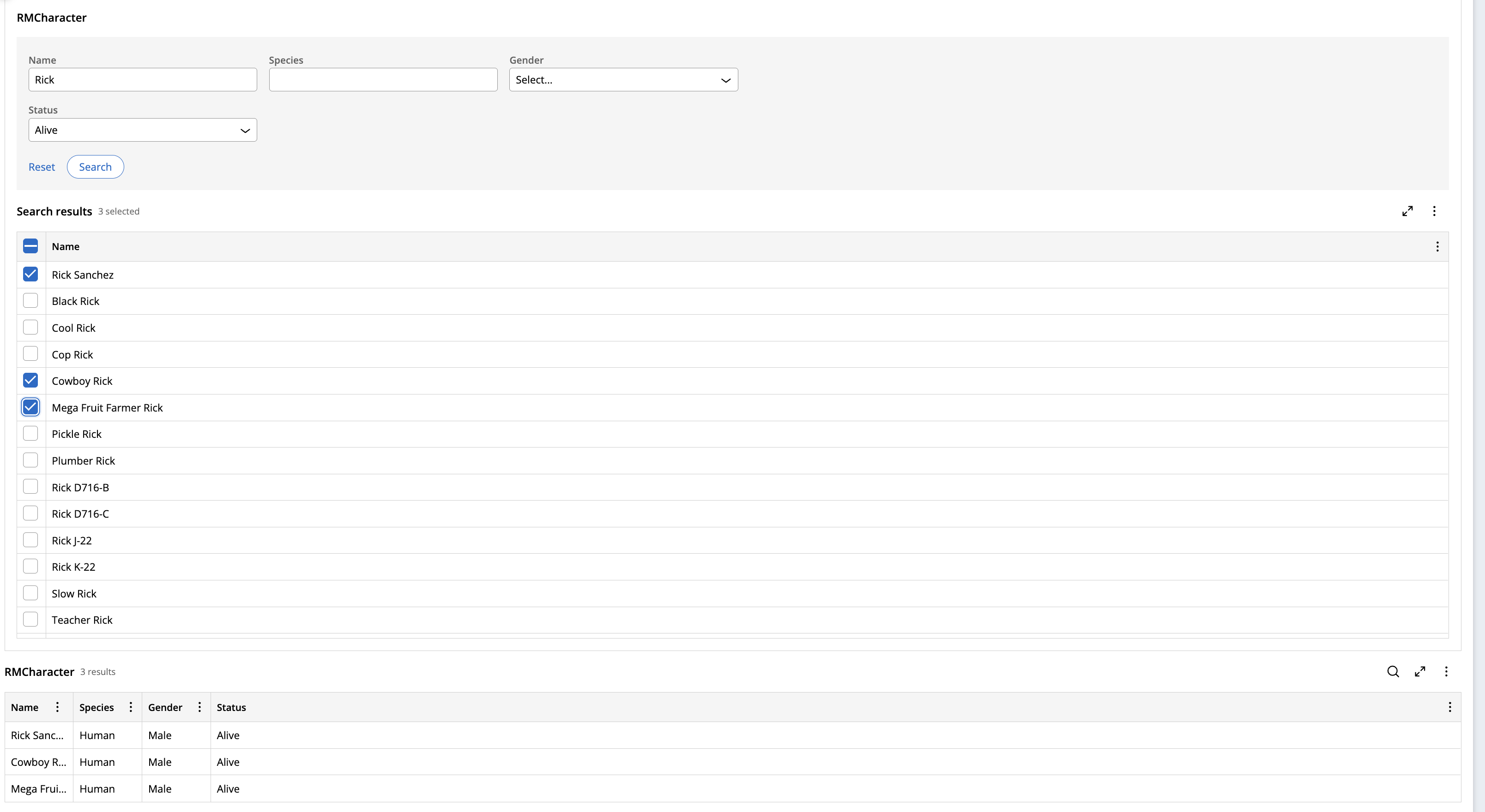

Initial Search

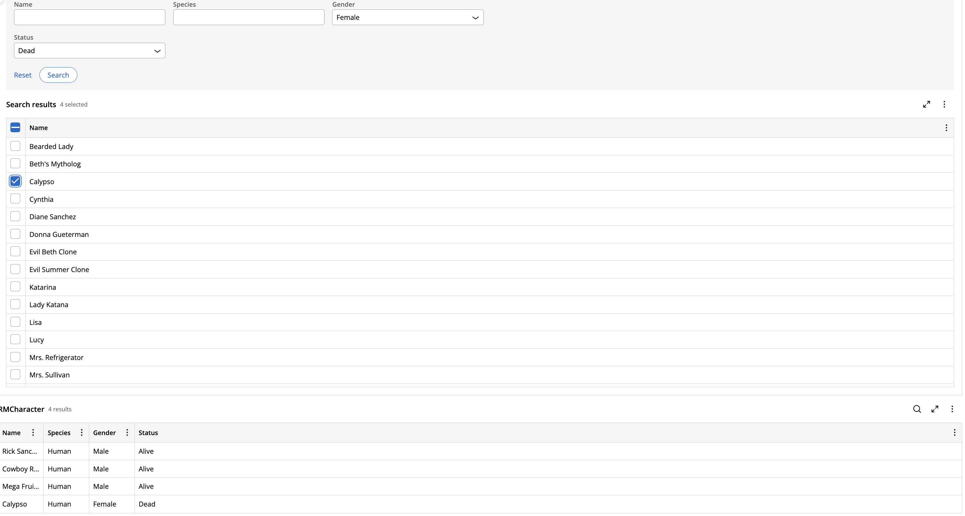

Second Search
