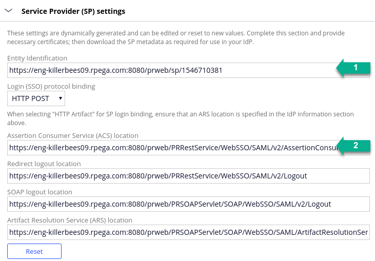

On the next screen, specify the Authentication Service alias, then scroll down to the Service Provider section of the page and note the following information, which you will need in the next step:
- Entity ID from the "Entity Identification" field
- ACS URL from the "Assertion Consumer Service (ACS) location" field
