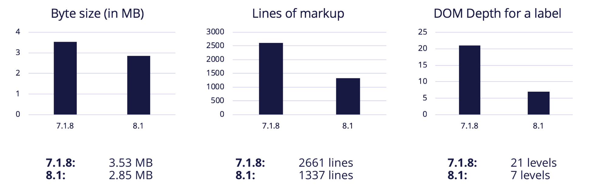

Investing in Pega software ensures that your applications are future proof, in that as technology evolves Pega updates the code it generates to the latest standards and improvements. We first introduced dynamic layouts in Pega 7. These were the first <DIV> based layouts introduced in our generated UI and were in part made possible by the deprecation of support for IE 5.5, IE 6 and IE7. We have stayed up-to-date with Microsoft and deprecated IE8, IE9, IE10 and quirks-mode based UI. This has enabled us to change the generation of the dynamic layout code to be more modern. As part of that evolution we introduced the ability to generate CSS Flexbox based markup in Pega 7.3. As part of that change we reduced the generated markup as well, thereby improving the performance over the wire and on the client since the browser processes less markup. In 8.1 we have taken that one step further and further reduced the markup based on certain configurations of the dynamic layout. As an example, if a dynamic layout doesn’t have a container or header specified, we reduce the markup by a couple of nested DIVs per layout. This can amount to huge reduction in markup. When we compare the markup of the Team Member gadget in the Case Manager portal between 7.1.8 and 8.1, we can see the following improvements:
Significant above is the savings in DOM depth as a large DOM depth can be attributed to browser performance during render.
