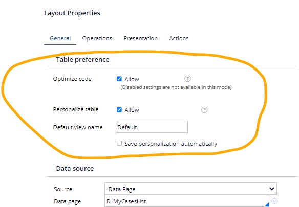

How to retain the individual sorting or filtering preference on My work list ?
Client has a requirement to allow individual sorting and filtering of the My Work list, and these individual preferences must be retained.
Requirement:
- Go to the My Work list.
- Set a manual sort or filter option.
- Navigate to another screen in the application (e.g., Reassign Work, open a Case, go to another worklist).
- Return to the My Work list; the previously selected sorting and filtering should be retained.
-- Recently, we demonstrated the Pega out-of-the-box feature of editing the Pega Dashboard (e.g., adding/removing widgets), which allows individual users to customize their view and persist those changes. The business wants similar behavior for My Work list sorting and filtering.
